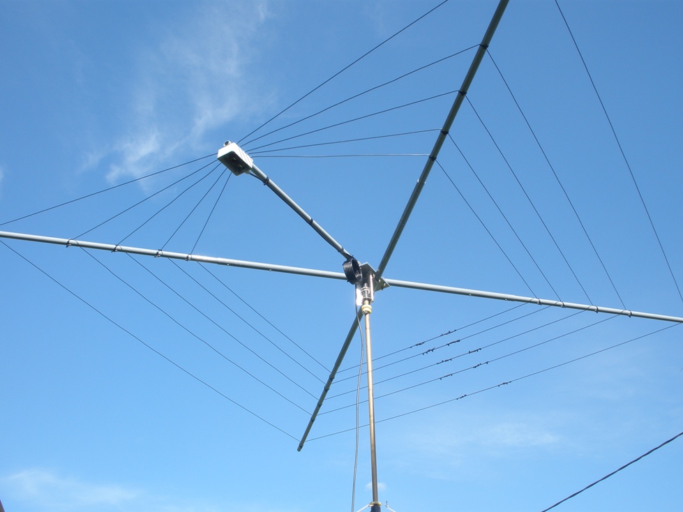

Jest sem si ravno zaradi pomanjkanja prostora naredil cobweb anteno.
Na strehi je že dve leti in moram reči, da sem glede na velikost antene zelo zadovoljen.
Edini problem je, kadar pada dež, se resonančna frekvenca zniža za kakšnih 150 khz,
ko pa se osuši pa je spet normalno.
73, Jože S51TX

OdgovorNapisal/-a S50DX » 01 Feb 2017, 13:06
Tale coweb že nekaj časa opazujem tudi sam. Nisem pa še čist preštudiral.
Mogoče neumno vprašanje... Za tole ne rabiš rotatorja?

OdgovorNapisal/-a s55o » 01 Feb 2017, 13:59
November 2008 A second look by Peter, G3LDO in the December edition of "Radcom" shows the Cobwebb can actually be better than a fixed dipole at the same height. He did EZNEC plots of a Cobwebb and dipole at 10 metres high. The dipole was 1db better broadside on but the Cobwebb, being omni directional was 4db better than the dipole when the dipole was end-on to the direction of the signal. Note Peter's plot of the dipole takes account of the effect of ground reflections which which "fill in" the theoretical nulls off the end of a dipole. He says that under certain conditions EZNEC shows a 10db advantage over a dipole! I do not know how often that would be achieved in practice
http://homepages.wightcable.net/~g4zfq/Cobwebb.htm
Antena je pač lomljen multiband dipol, torej seva v vse strani. Ni nikjer na netu kakšnega sevalnega diagrama, da bi lahko videl kako to seva.
